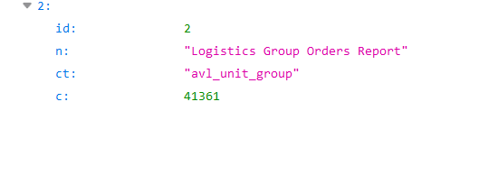

Hi all,
I am trying to find where I can get these information highlighted in red.
https://hst-api.wialon.host/wialon/ajax. … eport&
    params={
        "reportResourceId":163266,
        "reportTemplateId":10,
        "reportObjectId":34868,
        "reportObjectSecId":0,
        "interval":{
            "from":1357938000,
            "to":1358715599,
            "flags":0
    }&sid=<your_sid>
I tried to query the available reports to check if the  "reportResourceId" and  "reportObjectId" is available but no luck ( kindly see attached file)

Hello. Execute core/search_items with following params:
{"spec":{"itemsType":"avl_resource","propName":"","propValueMask":"","sortType":"","propType":"","or_logic":false},"force":1,"flags":8193,"from":0,"to":0}
Flags are 8193 = 1 | 0x2000
Response will contain items with resources and reports, that are belong to resources:
  "nm": "rual_test",
  "cls": 3,
  "id": 14809663,
  "mu": 0,
  "rep": {
    "1": {
      "id": 1,
      "n": "New report",
      "ct": "avl_unit",
      "c": 51426
Then, reportResourceId = 14809663, reportTemplateId = 1.
reportObjectId is an id of the item, on which report will be executed. In your case (ct: avl_unit_group) is a unit group id, in mine (ct: avl_unit) — unit id. They can be fetched via core/search_items too, with corresponding itemsType:
{"spec":{"itemsType":"avl_unit_group","propName":"","propValueMask":"","sortType":"","propType":"","or_logic":false},"force":1,"flags":1,"from":0,"to":0}
In the response there will be ids for reportObjectId:

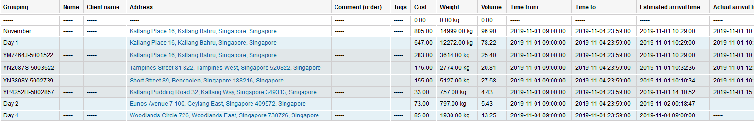

Hi Rual,
I am getting this result but it's empty and it only shows the table report header. Any thoughts what is lacking here? I did a test with the interval, ReportObject ID's (based from the result) but still it is empty. I also attached the report result from Wialon.  Thanks a lot for your help.
Report Object ID Result:

Report execution:
[url]https://hst-api.wialon.host/wialon/ajax.html?svc=report/exec_report&[/url]
    params={
        "reportResourceId":19694182,
        "reportTemplateId":2,
        "reportObjectId":20094932,
        "interval":{
            "from":1572598800,
            "to":1572602400,
            "flags":0
    }&sid=
[b]Response:[/b]
reportResult
msgsRendered    0
stats    []
tables
0
name    "unit_group_orders"
label    "Group Orders Report"
grouping
nested
nested
type    "unit"
type    "mday"
type    "month"
flags    536871176
rows    1
level    4
columns    18
