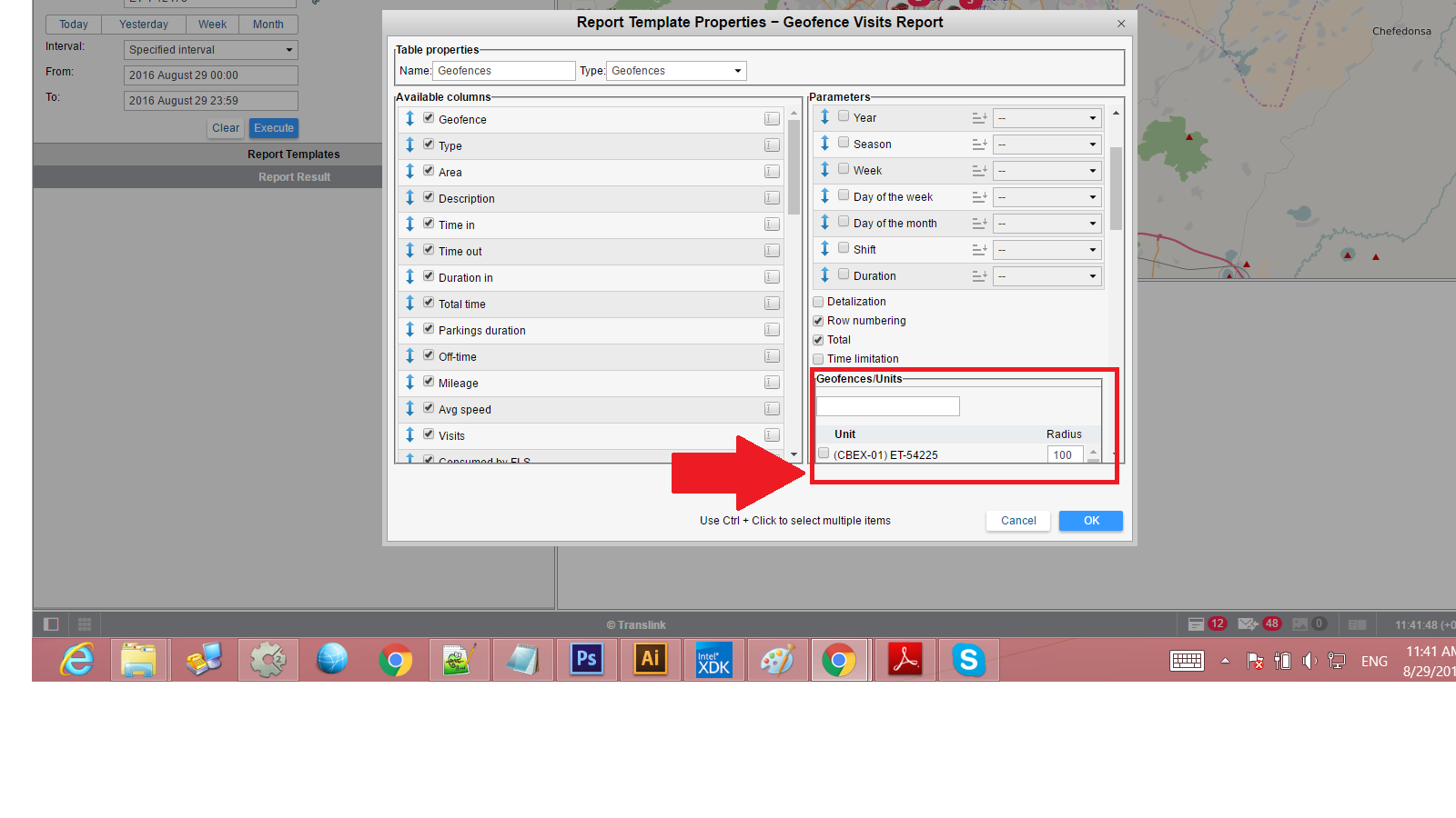

Hi,
I have system that fetch data from wialon and we use to have report in wialon generated and then fetched them with API calls to our custom app. It was working fine untill we have change in user. It appears wialon has complex structure in index and it got changed with user.
Any one please bail out as we are stuck as all api calls are falling deaf and we are not getting desired data.
Please have a look at attached file where we are getting unit name instead geofence and which is havoc in our existing system.
Regards,
Shah

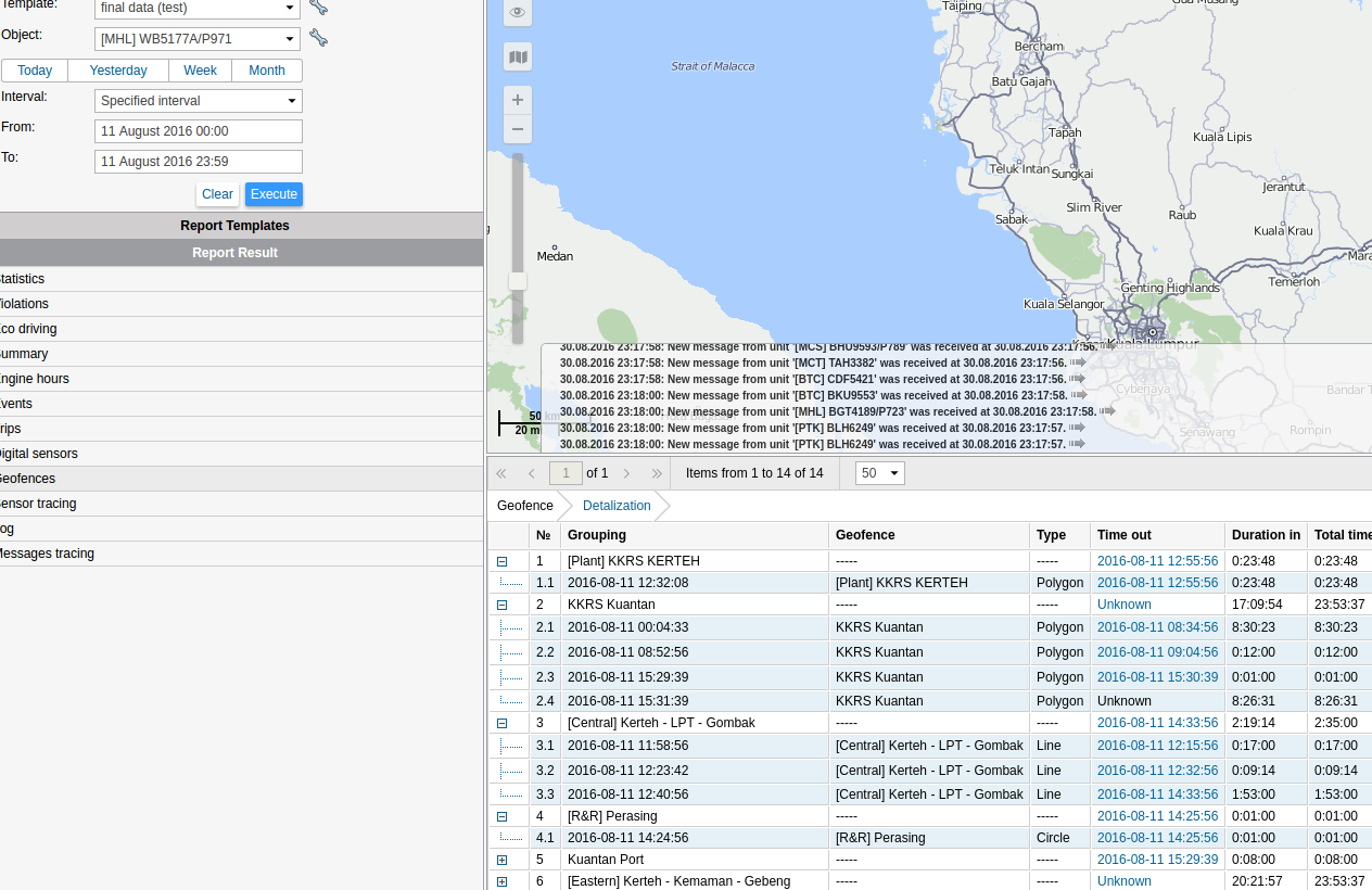

Thanks for your reply,
I have checked my credentials.
it is fine still getting unit name instead of geofence name.
Please help me out..
I have attached screenshot for reference.

shah007, in Your report template final data in Geofences table there is Geofences/Units section.
Almost all geofences and all units are selected. Units in this section act as virtual geofences with specified radius (100 by default).
If You don't need to see visited units in report (only geofences) just uncheck units in this section.

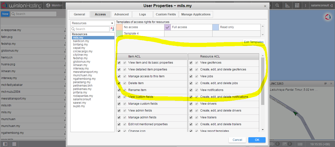

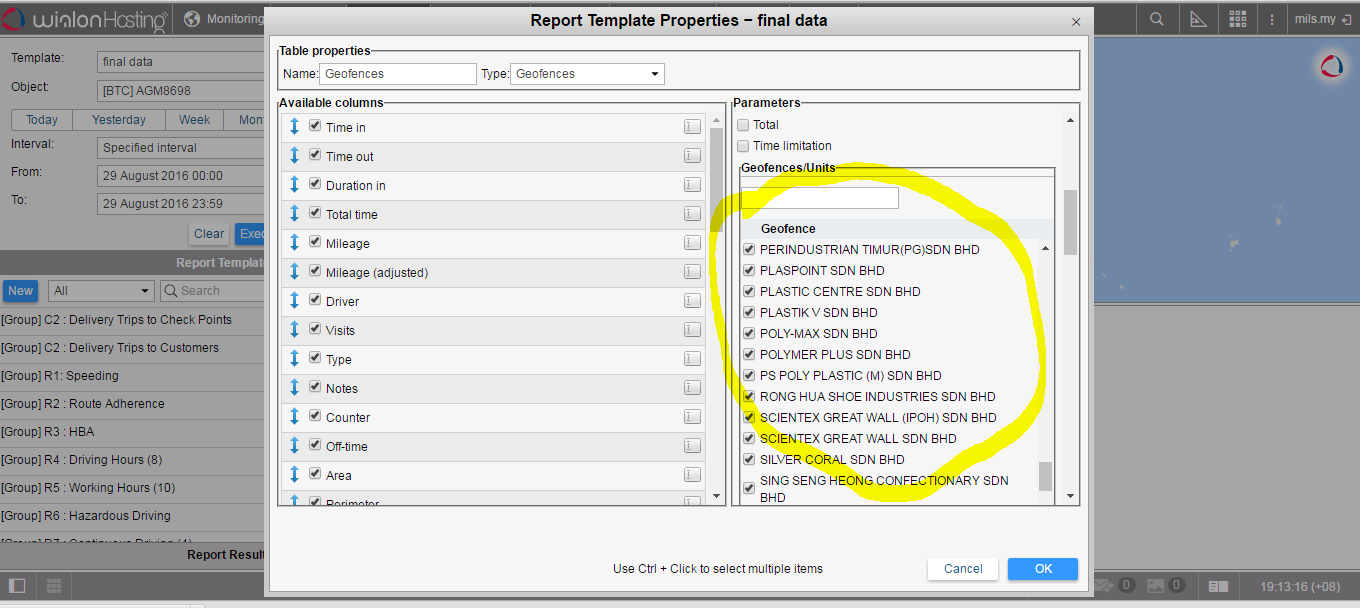

Hi, Looking in to your attached screen shot, it seems like you have selected vehicles rather than Geofences when you create your Geofence report template.  please see the attached to better understand what I am referring to.
In addition when you create your user please make sure you have assigned your user with the privilege to create, read and update Geofence resource. (please check the second attachment ) or the user has the privilege to have access to the resource consisting the Geofences.
If all are ok i think it is better to check the API request you are making.

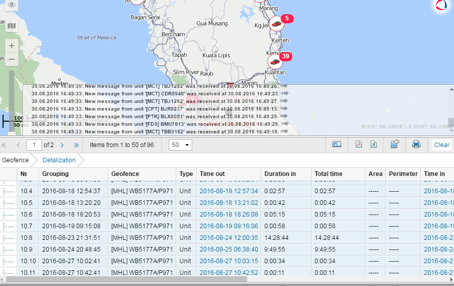

Thanks  for reply.
I have checked both the things. They are accessible but I can't get the geofence name in report.
Here I have attached screenshot for your reference

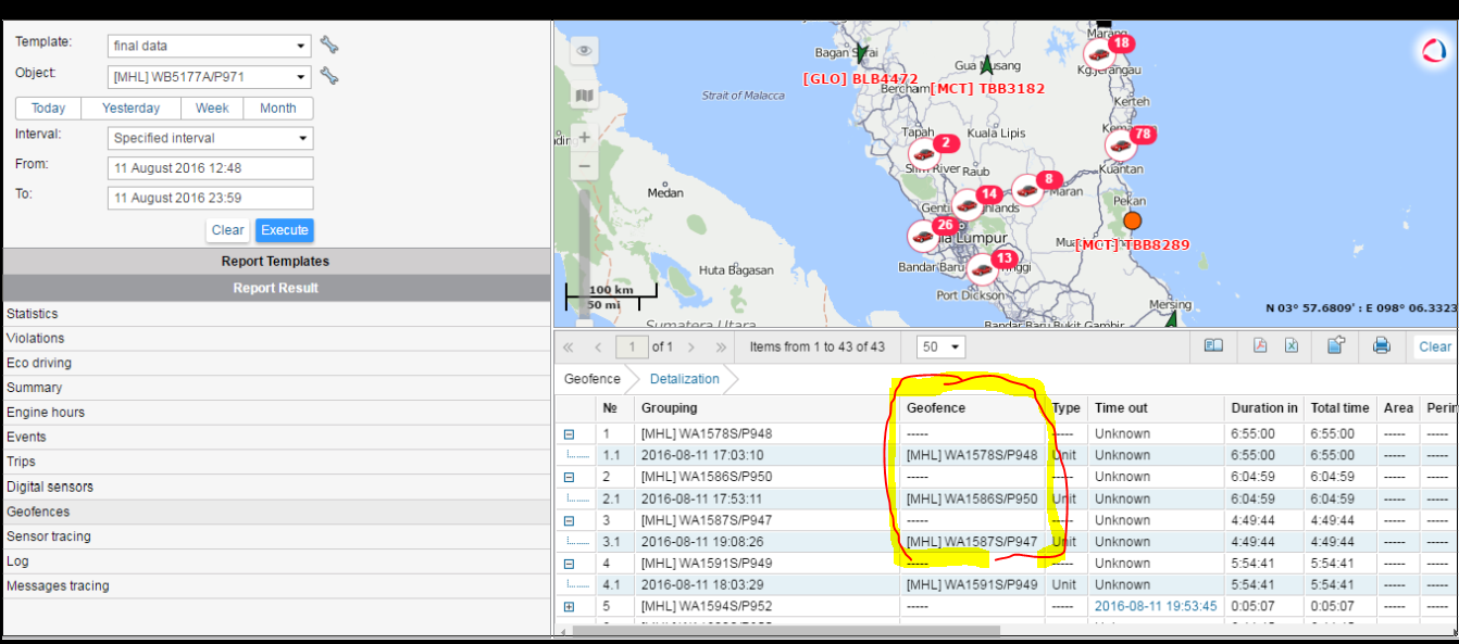

Thanks @deal,
I have unchecked all units and checked the same but still displays unit names.
I have attached screenshots

shah007, I've created copy of Your report template (final data) and unchecked all units in Geofences table and got only geofences in resulting report. Try it.
