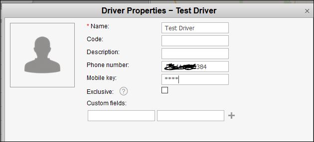

Hi Alan,
i think you do something wrong...
For Wialon Logistics you need to create a DRIVER with phonenumber and key=the password you later enter in the Wialon Logistics.
So having the Phonenumber as phonenumber of a UNIT and of a DRIVER should be possible!
And dont forgett to BIND the Driver to a UNIT, otherwise you will get (now) a error message!
Wolf.
Logistics
Re: Logistics

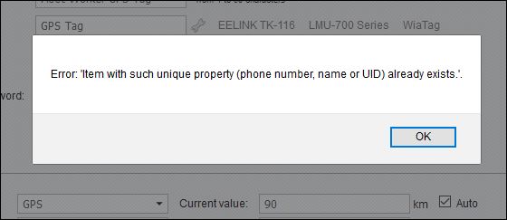

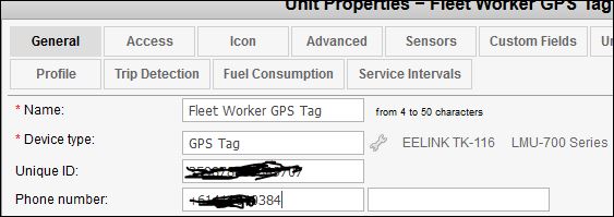

Hi Wolf,
Yes we created the driver with the phone number and key and bound to GPS Tag unit.
When we first did this we already had a GPS Tag set up in the system for the same mobile phone number. It wouldn't allow: "Error: 'Item with such unique property (phone number, name or UID) already exists.'."
We went in and changed the GPS Tag mobile number just so that we could use the Driver one in order to review Logistics App.
Later we thought we'd correct the mobile number GPS Tag is associated with so as to review as a whole solution as it should be, however - "Error: 'Item with such unique property (phone number, name or UID) already exists.'."
I have attached a couple of screenshots.
  • Logistics
  • Logistics
  • Logistics
Onwards and Upwards!!
Knowledge, data & information is power!
Logistics
Re: Logistics
FleetPursuit
Phone is unique parameter for all Wialon items
Try to leave phone in unit setting empty and set it only for driver
Logistics
Re: Logistics
Yes I have done this as a temp work around, but how will this ultimately effect GPS Tag?

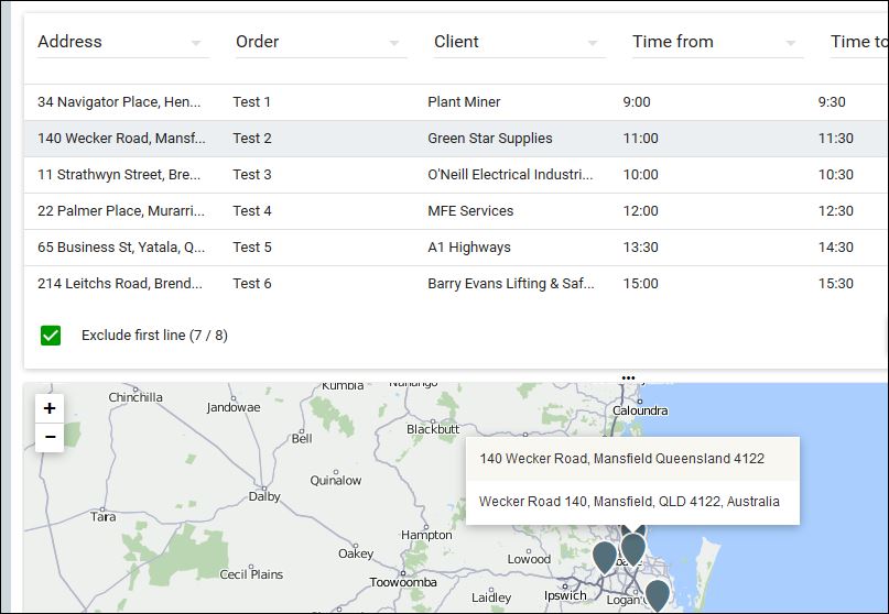

Hi,
Need a bit of help, clarification regarding importing orders.
We created a "test" list of orders, with Address (not coordinates), Order, Client, Time from, Time to and Comments - imported this and the list and correct locations were shown.
Set columns as required in Logistics - Address first.
Selected Save - and had a "pop-up" saying total number incorrect, in this case "All of them" then created an incorrect csv file to be saved.
Tried removing columns and adding deleting data all came back incorrect. Have attached a screenshot and csv.
What are we missing - we have done as we thought was correct as per documentation....
Cheers,
Alan.
  • Logistics
Post's attachments
Attachment icon Incorrect__orders __14_43.csv 544 b, 1449 downloads since 2016-03-23
25
Logistics
Re: Logistics
FleetPursuit
Time from/Time to should be full date (e.g 03-23-2016 8:00), format can can be set in settings
