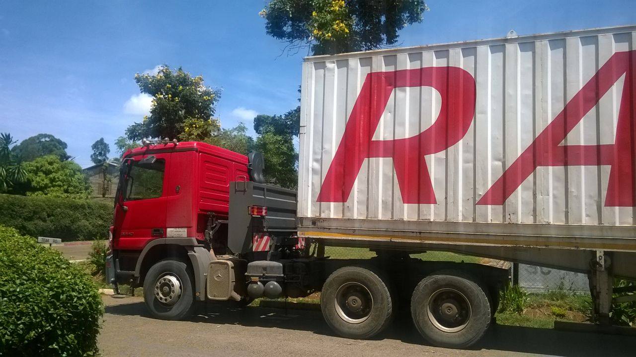

I have GPS device with 2 Analog inputs and supported by Wialon,my concern is that they want to implement Ultra Sonic Fuel Sensors Technology as the have 2 Tanks one which is 920 Ltrs and Original Tank which is 400 Ltrs and last time they tried with Fuel Level Sensors dint work for them .
One of the largest tank as shown in the photo below is locally made and its 110CM .
Previous problems they have had is that the drivers would disconnect the Trucks batteries and payphone the fuel and then return battery to avoid being seen they are stealing , they never had a power software and i believe with Wialon we can achieve great results , this is the common problem in Kenya and east Africa and can help me penetrate fuel once this is solved .
3.1 Such fuel tank - standard situation in Africa and South America territory.
