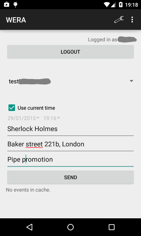

WERA is a small Android utility, which can be used to register events on Wialon.
WERA can be helpful if you want manually register information about some events. For example, it was developed for commercial agents, who should register information about visits to their customers. In this case the agent had a tracker in his car, but the utility can be used absolutely indepent of kind of tracker which is installed. The binding between the tracker and event will be established on the server during event registration procedure.
After the event was registered, the information about it can be used for any purpose. For example, to generate reports containing these data etc.
Screenshot: https://www.dropbox.com/s/0wdmcoq9k3mfo … n.png?dl=0
The current version contains three text fields for information. But it is planned to extend WERA for flexible field configuration.
If the internet connection is available the events will be registered immediately, without the connection they will be saved in cache. The cache contents can be sent to the server later.
