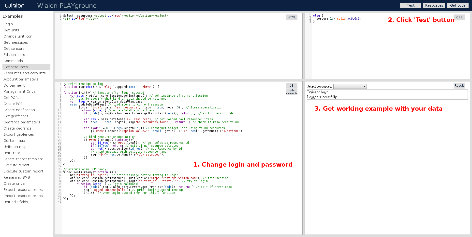

wwbusch aka Buwo wrote:
Hi Shal,
... and i can not use my own sample account.
In every playground sample you can find login code, something like
wialon.core.Session.getInstance().login("%USER%", "%PASSWORD%", "", function (code) { // login callback
  if (code){ msg(wialon.core.Errors.getErrorText(code)); return; } // exit if error code
  msg("Logged successfully"); // print login succeed message
You can change %USER% and %PASSWORD% to your demo account and press 'Test' button in upper right corner to aply changes. See attached image.
About sample code: i'll try to help you in a couple of days, havent time for it now sad
