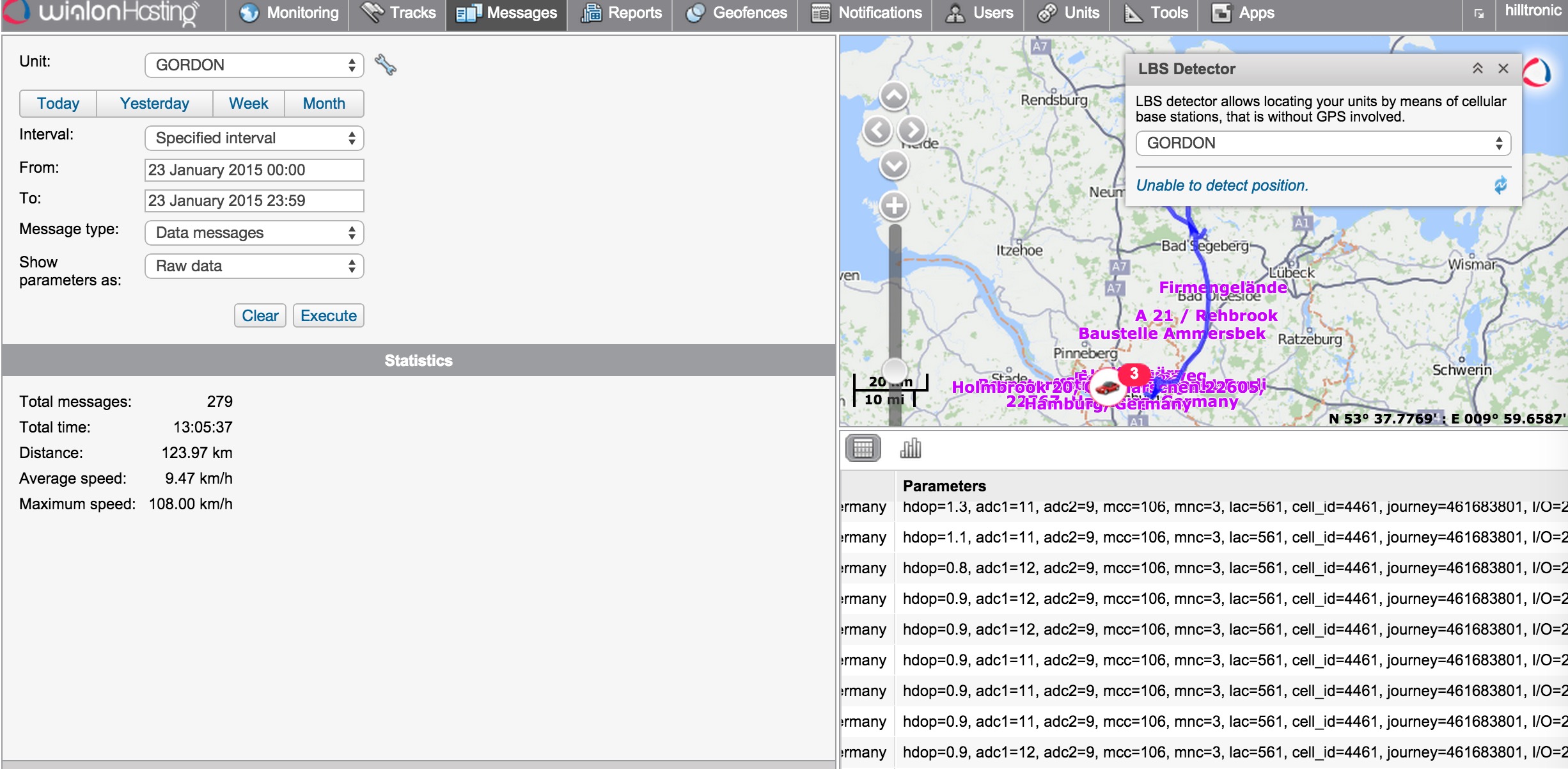

Hi Shal,
here is a case for your debug guys :-)
Device "GORDON" = VT310, it tells for MCC=106 but that is hexadecimal.
(rest of data is also hex as i remember), so that does not work with LBS lookup...
I know that some HW sends data as HEX and some as decimal, so how Wialon handle that?
Wolf.
