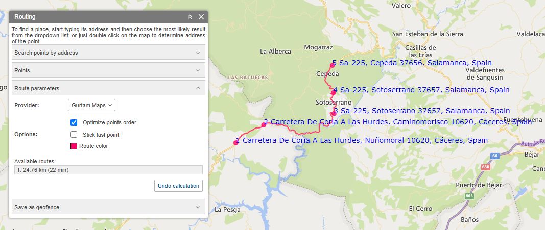

Ive been trying to find a way to execute thruogh the Remote API, the "Routing" tool on the Wialon Hosting platform (see image below), I would like to provide the coordinates of all points in a non optimized order and get in return the optimized order and total time and distance
Routing tool throuh Remote API
The closest I got was through the comand "svc=route/optimize", but one of the parameters is a matrix with the distance in time between all points, wich I dont have, I only have coordinates, is there a way to get those distances? Or maybe another command to execute the "routing" tool?
