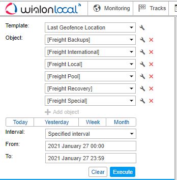

Regarding the reports, I haven't gotten there yet as I am still trying to come to grips with how to get Apps Script to work with the API.
However, I have already created a report which we are running using the Advanced Reporting module which we purchased. Only thing we need to do is add all the required Item Groups as objects and the report works as we require. I will attach a copy of the report for your reference.

Google Sheet updated by Wialon Local report - Apps Script
Re: Google Sheet updated by Wialon Local report - Apps Script
Hello shalin.lazar !
1. If the error related to Apps Script, unfortunately, we cannot help with this.
When you execute POST request to login into Walon (  for example, https://hst-api.wialon.host/wialon/ajax.html?svc=token/login&params={"token":"2fe8024e0ab91aa6c8ed82717b71bddcECDC362358DF7D90986F5173D405CD0D42DE7B38"}   ), the server will return response in JSON format.
2. To get items id - you can use request searh_items, and search element by name.
Please look example how to find users, the same you can use to find unit, resource, just specify the proper 'itemsType' - avl_unit , avl_resource
https://sdk.wialon.host/wiki/en/local/re … arch_items
Also (some lifehack ) you can open Develop Console in browser, and look which requests  going from Wialon , when do one of the action.
For example report's execution.
Diana Cheley
Wialon Hosting Expert
