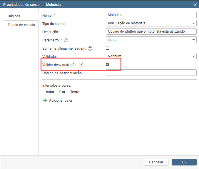

Hi Fernando Brochetto,
that is great that you have found a workaround. But have you seen automatic binding solution which is described here: https://docs.wialon.host/en/hosting/user … ic_binding?
I think some pieces of information could be useful for you. For example, the option Validate unbinding can be useful. If the option is activated, a driver bound to a unit automatically can be unbound from this unit only if the empty value comes from the same parameter that was used to bind the driver.
Otherwise, driver reset coming from any parameter will lead to the reset of all drivers bound to this unit.
A driver can be unbound from the unit upon receiving the parameter with the unbinding code configured in the properties of the Driver binding sensor, and also upon the activation of the corresponding notification (for example, upon switching off the engine). When a driver with enabled Exclusive checkbox is assigned to a unit, all others are automatically unassigned. This function is relevant for drivers created within the same resource.
Do you find this information useful for you?

Hello mapa,
Yes, I did know about these features, but the problem is that firstly, the tracker we use sends only the parameter with the code when the cards are passed through the reader and also the drivers do more than one trip in a day, so they turn off the ignition very often. As they need to get the interval between when the driver started and finished, we need the bindings to work in the way I've described. The use of notifications has helped us in the workaround I've shown.
