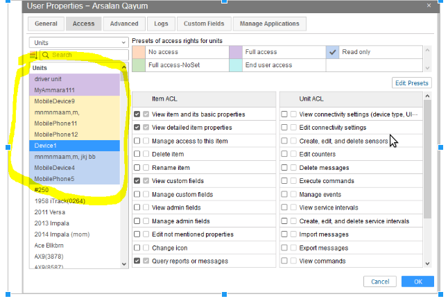

Hi,
I have to search a user and all units associated to that user.
I am working on a web app from I have to edit users, when editing a individual user, I need to get all units which are assigned to that user.
Perhaps, it is similar to searching "avl_unit" and it's all sub itmes such as "unit_sensors", explained here: https://sdk.wialon.host/wiki/en/sidebar/ … arch_items
Please take a look on the screenshot attached below. It shows a user edit in a modal, and under access tab, you can see colored units which are assigned to that user.
Want I want is to search all units which associates with a user. In the Wailon CMS dashboard, it works fine. But I could not find the API to search the same results.
I also could not find the API to search "Presets of access rights for units"
Can anyone here help me find these APIs? Or let me know what APIs I need to hit in order to get the same results? Thanks
I look forward to hearing from you.

Hi Diana,
Thank you for your reply.
However, I am still not able to find the API I am looking for. Let me briefly re define what I am looking for.
We are trying to figure out what API call will allow us to look up a user for example Arsalan Qayum, and see what units are assigned with what specific permissions to this specific user.
For example, how do we have our web app pull the following circled information for this specific user seen in the screenshot below.

Hi Arsalan,
To get info about access to item class (as on screenshot) you can execute request user/get_items_access
For example with the following parameters we will get all items (resources, group, units) which user have access (direct access and exceeded access(fir example via group's access to units)
params":{"userId":19463338,"directAccess":0,"itemSuperclass":"","flags":3}
You can also to specify "itemSuperclas",  for example "itemSuperclas":"avl_unit"  returns only units.
Diana Cheley
