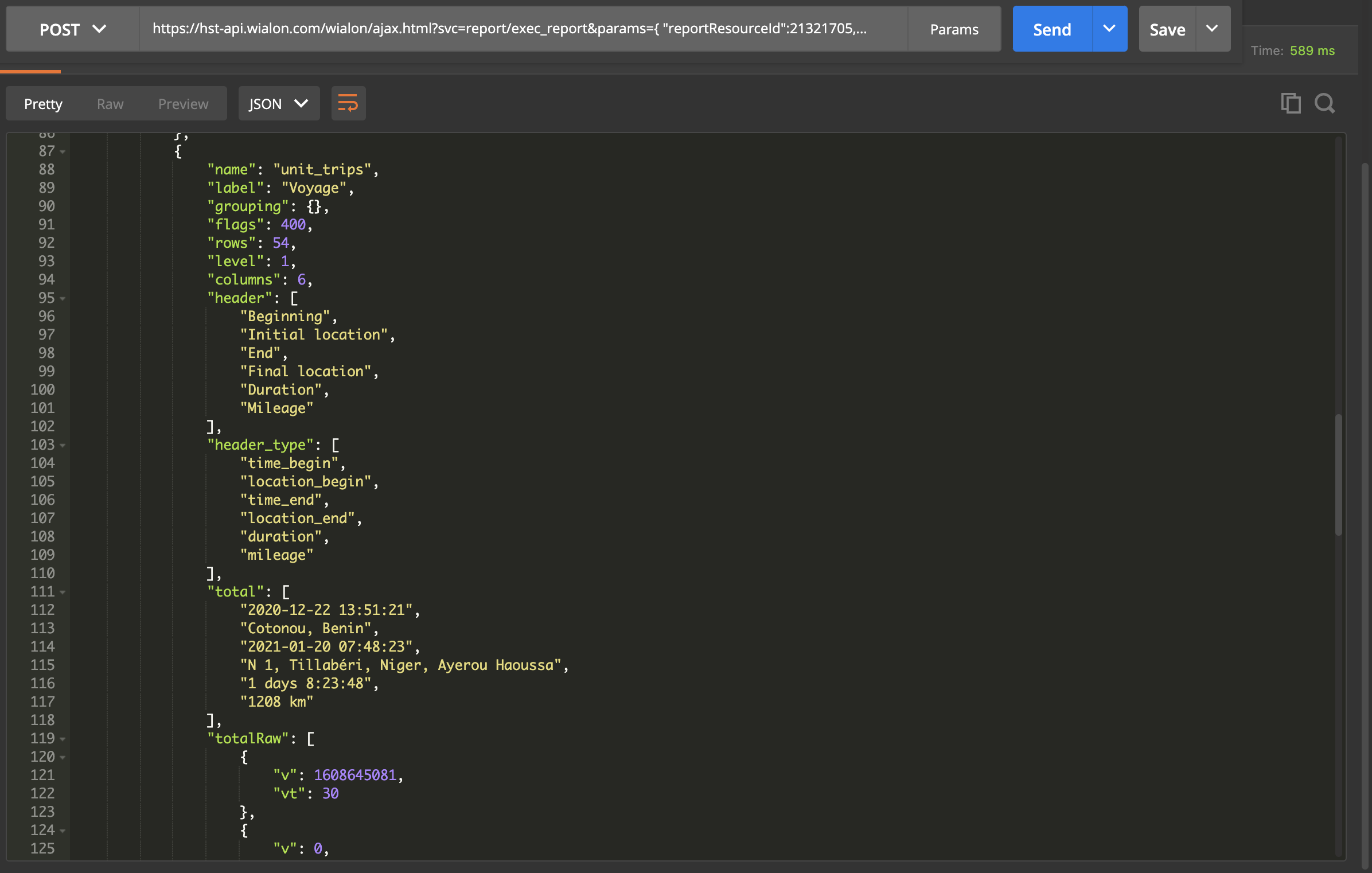

we have a problem.in ours case for eg, we can execute report and get response. But, in the response, we did'nt get the unit trips detail, we just get the sumary wich contain the start and the end of the trips. Note that the report template that we are using is an trips report template that whe had create on platform.
Tached screen explain more
1- report excec result form api
2- report exec result from platform
. Can you advice please ?

Hi megb !
After you execute request, you get a report content (how much tables, which ones, which row levels have and etc)
Then you need to execute request to get tables data.
Using the request report/get_result_rows. It is suitable for most reports. However, it returns only rows of the top level. If you have a multilevel report, you need to make an additional request to get the rows of lower levels – report/get_result_subrows.
Using the request report/select_result_rows. It returns JSON that contains rows of all levels.
In my opinion is more convenient to use second request report/select_result_rows
For example,
https://hst-api.wialon.host/wialon/ajax.html?svc=report/select_result_rows&sid=02a11914b29a58aa81c602eed3df0396
params: {"tableIndex":11,"config":{"type":"range","data":{"from":0,"to":13,"level":1,"unitInfo":1}}}
in your case the corresponded "tableIndex"  and "rows" ("from"/"to") in “tables” array (for table  "name": "unit_trips")
Please look more deatiled example here also https://sdk.wialon.host/wiki/en/sidebar/ … es/reports
As some advice - you can always look at Developer Console which request is executed, when do some action on platform.

hi dyana. thanks for your response. We tried what you advise but we always gets wrongs params.
According to our case, when we get the tables rows blelows, do you confirm this values of unit_trips :   "tableInd:" 1, "level":1 and the "from":0 ,"to":53 ?
Also does it possible to dm you for more explication? my email is megb@sliafrika.com

tried request
https://hst-api.wialon.host/wialon/ajax.html?svc=report/select_result_rows&params: {"tableIndex":1,"config":{"type":"range","data":{"from":0,"to":53,"level":1}}}&sid=312ce86cc0ad70bedd774e0573f883d6

Hello!
In your example above the following table data :
first table Parkings ("unit_stays") ,  "tableIndex":0  as 1st element in array, named Parking, 5 columns ("header" array), 1 level grouping, rows = 55
second table Trips ("unit_trips"), "tableIndex":1, named "Voyage",  6 columns, rows = 54, level 1
3rd table Stops ( "unit_stops"), "tableIndex":2, named "Arrêts", 4 columns, level = 1, rows =2
So to get Trips data, you request is correct
