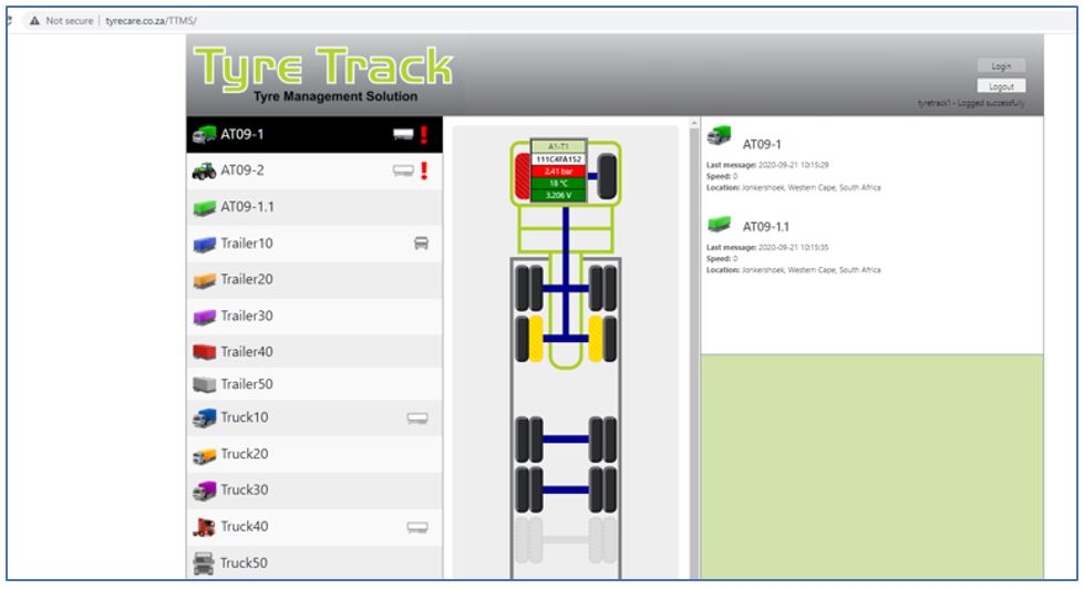

Regarding the login, I think the way you suggesting is the way I am doing it?? Please see the attached js file (functions getToken and tokenReceived).  I am an old-school C# desktop programmer with a little bit of JS background and very new to “web” programming, so I am closely following the sample code in the playground at the moment. ANY comments/critisism on my code will be very much appreciated! Just a bit of background on what I am trying to achieve.  Our cutomers use GPS devices with TPMS sensors on both their trucks and trailers, so for each trailer we have to create a Unit as well, with the same name as the Trailer to make use of the binding feature. Our customers are only interested in the pressures on each of their tyres on their trucks and trailers (www.tyrecare.co.za/TTMS)
