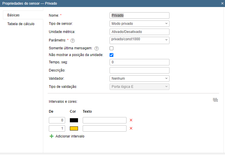

That's what we're using today. The client doesn't need the counter mileage:

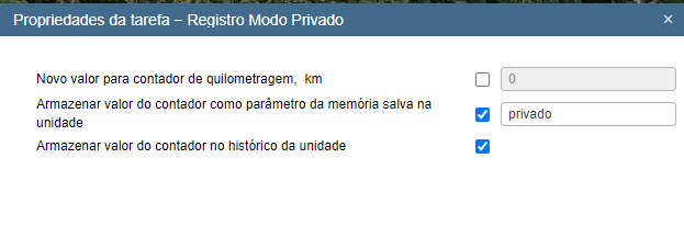

01) we created a task to register the counter;
02) created a sensor "Private mode" based on the parameter that has been registered;

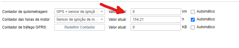

03) when the client want to enable the private mode, he change the counter to "1", when he wants to disable, changes to "0".
