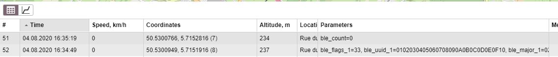

I'm using ELA BLUE COIN ID for driver identification.
I use the ble_uuid_1 parameter for the binding. It works fine.
What should be the unbinding code considering the attached screenshot ?
The second message is sent when there is no Beacon in the tracker range.
Regards,
Julien

I have found a solution with notification.
Driver unbinding when parameter ble_count is in range 0 to o.
