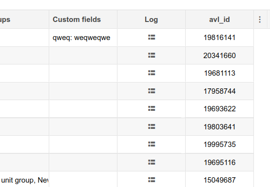

Hello. There exist undocumented feature, that we are using for development, you can open CMS Manager with such url — https://cms.wialon.host/?features=avl_id
After that column avl_id will appear and you can click on id to copy it to clipboard:
