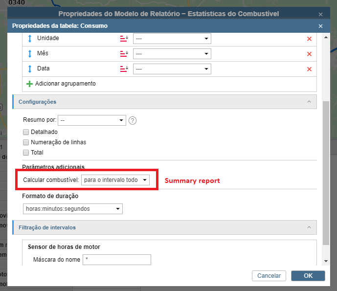

1) View 'Consumed by FLS', 'Engine Hours With/Without Movement' and 'Fuel Consumed With/Without Movement' information in one report. All these columns are presented in the Statistics report.
In regards to the fuel consumed information, these data should be the same in columns 'Consumed by FLS' in Statistics and Summary (use 'for whole period' setting in the report template) reports.

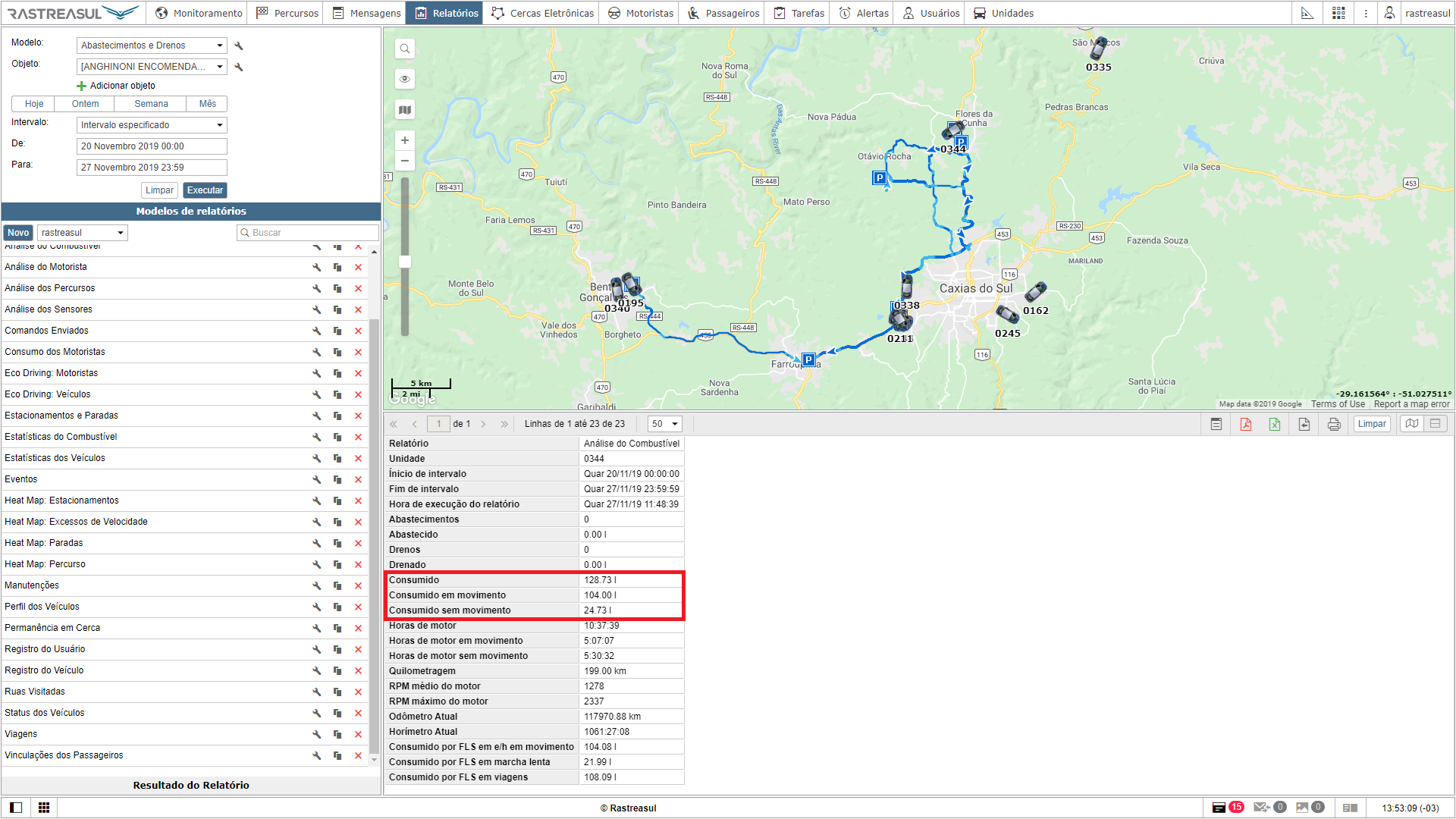

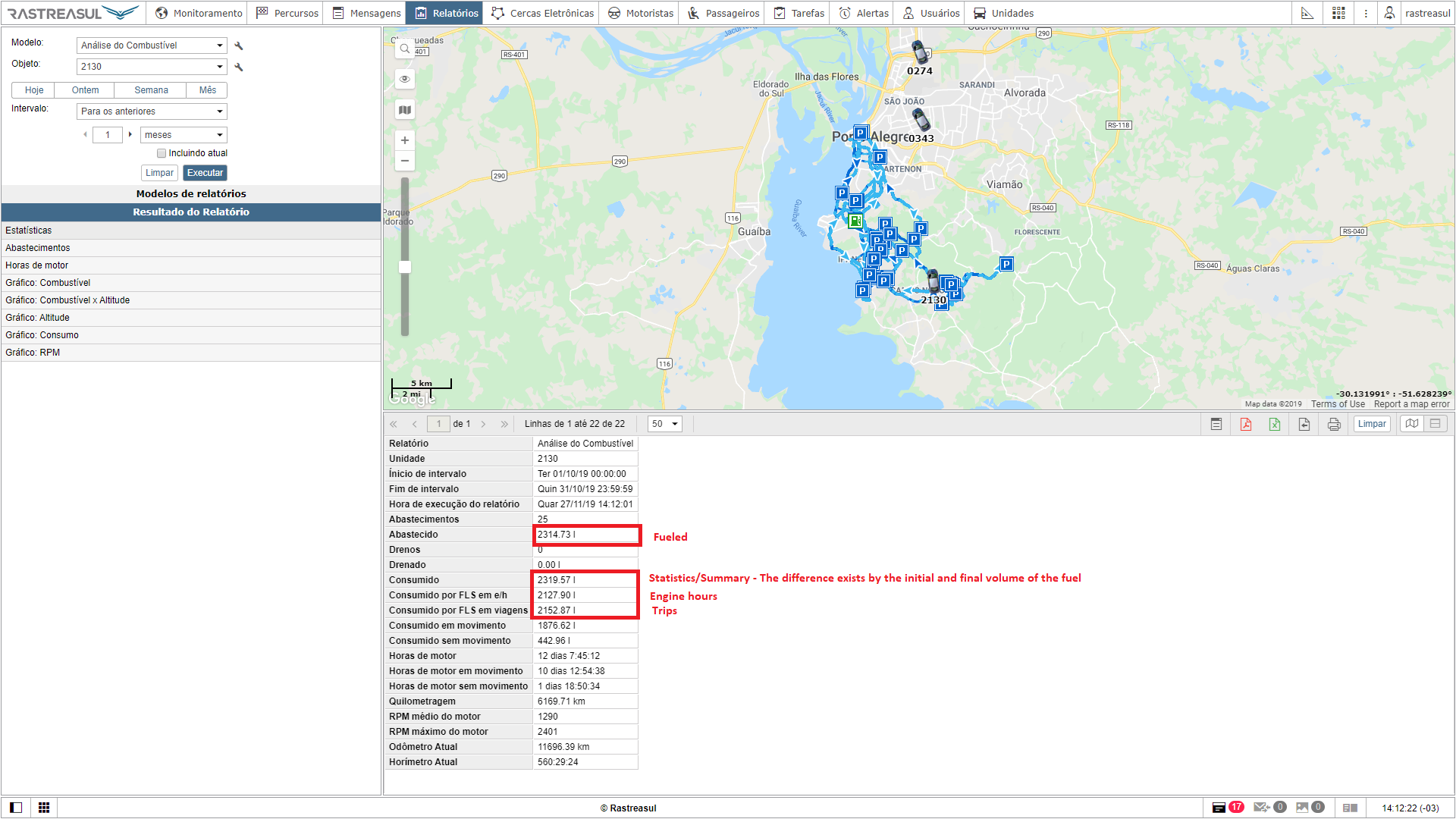

Problem:
The consumed volume by FLS it's different when consider by Engine Hours, Trips and Summary reports. The value that our clients uses are provided by the summary report only, but it doesn't have many metrics as the others.
The value:
As shown in the first screenshots, there is a significant difference happening when you use the values of consumed during the engine hours or trips to summary, probably caused by the imprecision of the FLSs during the vehicle with engine off. The right value theoretically to use was the difference of the inicial and final value of the fuel level + the fueled volume, so it would be possible to have the right average from the fleet. This value already exists and it's on the summary report, but as I said before, the report doesn't provide the metrics of consumed volume with/without movement neither engine hours with/without movement, so that will be possible to calculate the average wiht/without movement.
It's possible to use the engine hours/trips, but the difference of the real total consumed volume will reach many times around 10%.

We used to monitor fuel in Omnicomm platform, the platform from the trackers and sensors we use. This system can only calculate fuel consumption like the summary report:
Fuel Consumed = Fuel Fueled - Fuel Theft +  (difference between the inicial and final volume)

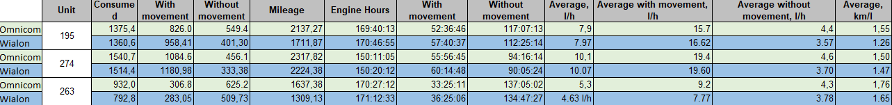

The way that trips and engine hours calculate the fuel consumed is different and are the only reports that contain columns with engine with/without movement and fuel consumed with/without movement. Without these columns in the report summary we can't calculate some averages like average with movement (km/l and l/h) and average without movement (l/h).
in the screenshot and excel file I'm sending, you can notice the difference of fuel consumed and averages between both platforms: the values we believe that must be used are the ones that is coming from the Omnicomm, because it consider the total volume of the fuel filled in the vehicles and the difference is slightly high.

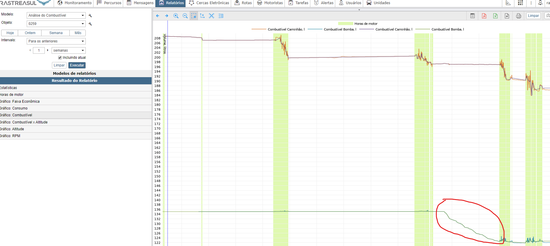

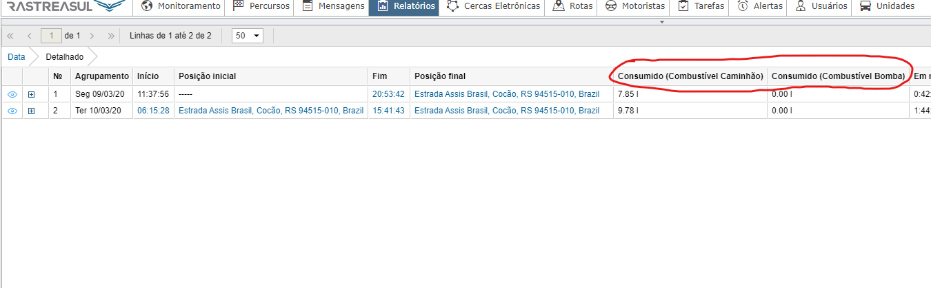

I found another case where I need to have the values of fuel spent without movement, please look the screenshot.
Today we started installing FLSs in Concrete Boom Pumps. These trucks have two engines and two fuel tanks (it's like two vehicles in one). The problem is that from CAN bus we can only get the engine parameter from the tank of the principal engine, the engine from boom pumps we are not having parameters.
The only place this fuel spent appears is in statistics table: fuel consumed without motion or the total value in summary report.
Another thing is that the only place this fuel appears separated is in the reports by units: by groups appears only the total volume of the fuel.
Is there any way of making appear the values from both fuel sensors in reports by group?
