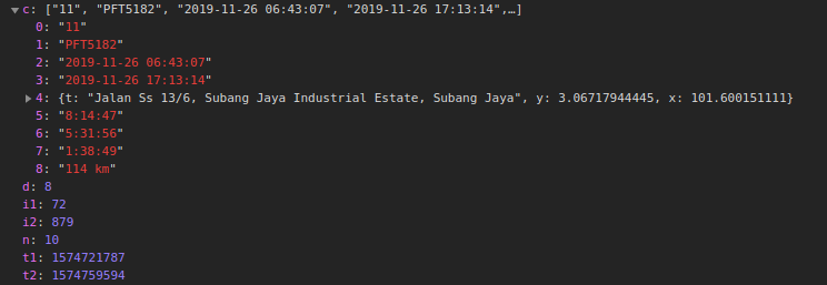

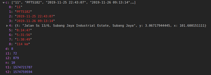

i am getting
2: "2019-11-25 22:43:07"
3: "2019-11-26 09:13:14"
but in your application getting:
2: "2019-11-26 06:43:07"
3: "2019-11-26 17:13:14"

Hello!
1. Reports results, messages result and other layesr are using UNIX time UTC+0
To get resutls with user's time zone you need to execute request render/set_locale after login
2. To execute commands the value is 16777216 - bit 24 is activated, but for value =  19327369763 the bit 24 is not
Please check the token access ritghts first.
