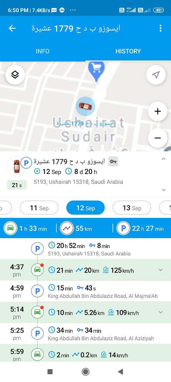

1)With the above APi how I cant get
The engine is ON or OFF
Car in the parking or running
Speed of the unit
Last update
Last physical address of the unit
name of the driver
svc=core/search_items&params={"spec":{"itemsType":"avl_unit","propName":"","propValueMask":"58415","sortType":"","propType":"creatortree"},"force":1,
"flags":4611686018427387903,"from":0,"to":1000}}],"flags":0}&sid=4d2ab565a7d0a1ee5fcdebe7c7bb1a63
2) How to apply filter by date to get units with all the above fields
