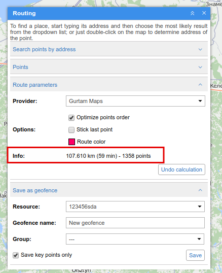

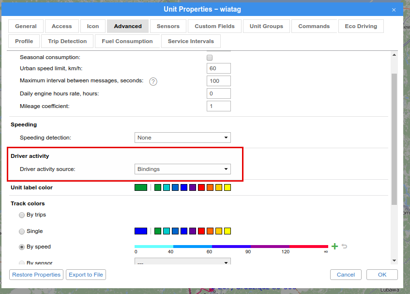

souleymane222, the description of the issue you are solving, unfortunately, is not clear. But I'll try to suppose you some options to find some data similar to ETA.
First is a  Routing tool. You may choose points, routing provider and options for routing optimization. After the optimization, you'll see the total distance and time for this route.
If you need info about your driver according to AETR rules, then you may try on the option "Driver activity" in unit's properties. You'll see the data about the current state of driving in unit and driver tooltip and in reports. Tachographs show more accurate data then bindings, but you may look does this option solve your task.
