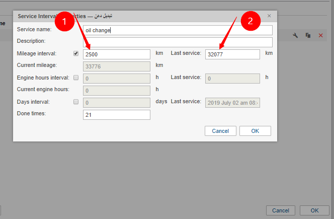

as you see in the image below (the maintenance work) i created an oil change service and pressed OK .
now the unit will countdown from 2500 to zero.
if i export this service to other units, the countdown wont start from 2500 because of the (last service which is NO 2 in the image ), sometimes an invalid data text will appear.
my idea is that when i export the maintenance work i should have the ability to export only the mileage interval without (last service), so when i import it to other units they will all start counting down from 2500 to zero.

Hi, hasan.ahmed!
Yes, the idea is totally clear now.
As far as I am aware, there are no plans to implement any enhancements in the Maintenance module of Wialon so far as some time ago we have released Fleetrun — the application that is particularly dedicated to any operations connected with controlling maintenance, repairs and costs for al this. Thus, we are focusing on advancing Fleetrun rather than adding features to the existing module.
But I believe that Fleetrun has a solution for this case of yours.
In Fleetrun (in contrast to the Maintenance module) you can assign as many units to one interval as you want. The interval frequency is the same for all units, but all of them have a different 'Last Service' value. Consequently, the services for each unit are created independently in different point in time.
Such an ability will eliminate the necessity to export intervals from one unit to the other.
