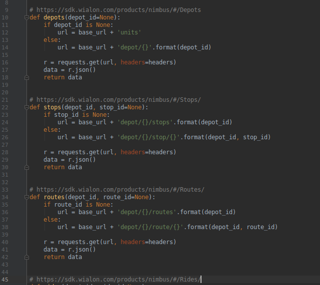

After spending some time testing the nimbus API, I be able finally to draw the route on the map.
Now I have another problem, I want to be able to move the units across the map.
Could someone tell me how to get a list of units with their respective positions (with Nimbus API), to be able to show on a map the movement of them?

Hello,
Again I have a question regarding routes and units.
How I can to know when a unit is associated with a specific route?
Because I consult the endpoint of "routes" with nimbus API, and all the routes returns me the same array of units
Is there any example to get data like locator https://nimbus.wialon.host/locator/? I can't find anything in github, stackoverflow or google, and docs confuses me a little
