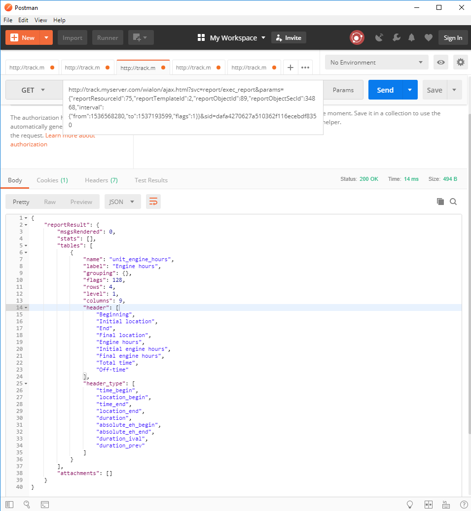

Re: Custom Report
I cant take the data of the header
how can I receive the data of the report

Hello.
To execute and get information to a report template normally you need folow the next steps.
1. report/execute_report.  https://sdk.wialon.host/wiki/en/sidebar/ … ec_report.
2. report/select_result_rows https://sdk.wialon.host/wiki/en/sidebar/ … esult_rows
3. report/cleanup_result https://sdk.wialon.host/wiki/en/sidebar/ … nup_result
You can show a good example on this url
https://sdk.wialon.host/wiki/en/local/re … /reports?s[]=report&s[]=select&s[]=result&s[]=rows
Best regards
