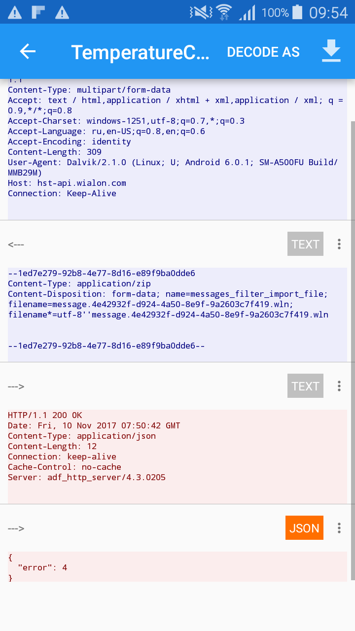

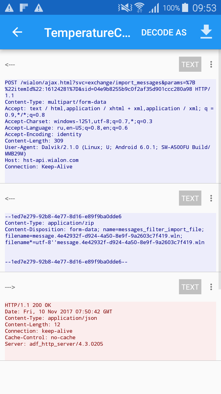

I also attach the sniffed http communication from my device to the remote API, which exactly mimics your example.
Now, always getting the impossible to debug on my side error 4, could you give me a hint what might possibly be going wrong.

Karnaugh, hello. Sorry for long waiting of answer.
Error 4 you can get for this request only if file was not sent or sent with wrong parameters.
Your headers and content have some differencies with browser's ones:
1. content-type:multipart/form-data; boundary=----WebKitFormBoundarySpQSQhs0MtJaVfeg - no boundary was set
2. Content-Disposition: form-data; name="messages_filter_import_file"; filename="kind.zip" - name and filename in quotes
3. Content-Type: application/x-zip-compressed - insted of application/zip
.wln messages import returns error 4
Re: .wln messages import returns error 4
Hello deal,
Your answer was pretty informative and the problem was actually the boundary. Now that it is set, everything works fine. It does not need to be the chrome string, but I do not dare touch it now that it works. (superstition on the way...)
