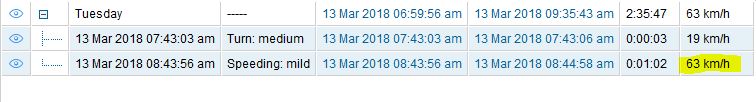

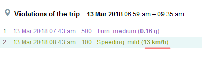

We have just started trailing this for a customer's fleet of trucks, primary need is to capture harsh acceleration.
I have a question regarding the "default" speed calibration/config and how it is reported.
We have run a few reports and viewed/compared with the Eco Driving app. My question after reading docs it says that speeds are drawn from Google maps.
If this is so, why does this speeding not show up when we generate a separate speeding report?
In one instance a speeding violation is shown in both Eco Driving Report and Eco Driving App however it does not show this speeding instance when a Speeding Report is generated.

Hello,
Please, clarify, where have you found this information.
Please, send more information about this issue to support@gurtam.com:
* user name
* unit name
* report name
* time interval to check

Cheers Oleg,
I think we have found why speeding shows in Eco Driving but not in a standard Speeding report.
We have noted that customer units are setup in Advance settings as "Use fixed limit" speed, rather than by "Use limits from roads".
So with Eco Driving taking speeds from road limits as is noted in doc: https://docs.wialon.host/en/hosting/cms/units/eco a Standard Speeding report will not show this given the different Unit Advanced settings - only showing in the Eco Driving. smile
