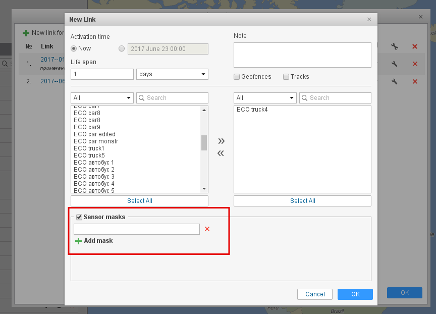

yuab, I can't use new Locator in our account with Beta branch, Locator is still same as was
Essential changes in Locator
Re: Essential changes in Locator
Sensors masks should be set up before you open link. I've attached screenshot where you can find them.
If you have no such dialog in hosting.wialon.host(Beta), please, let me know

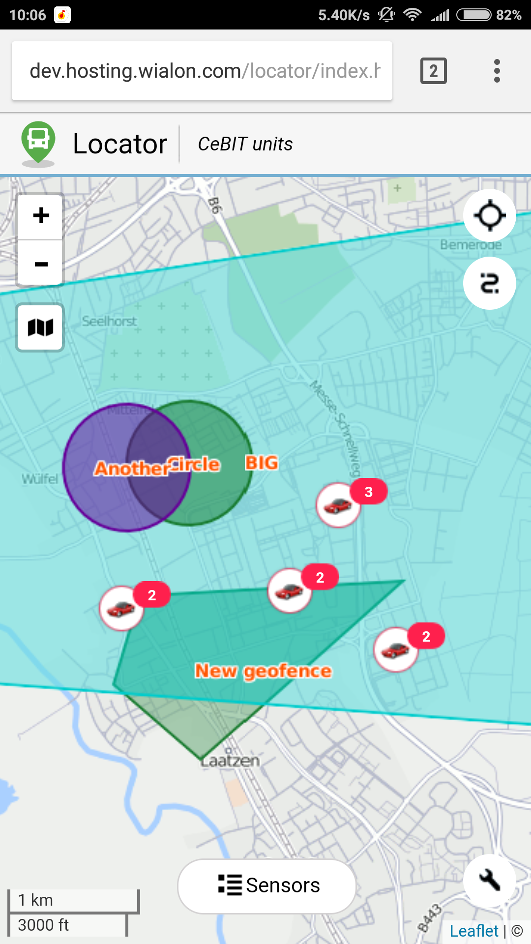

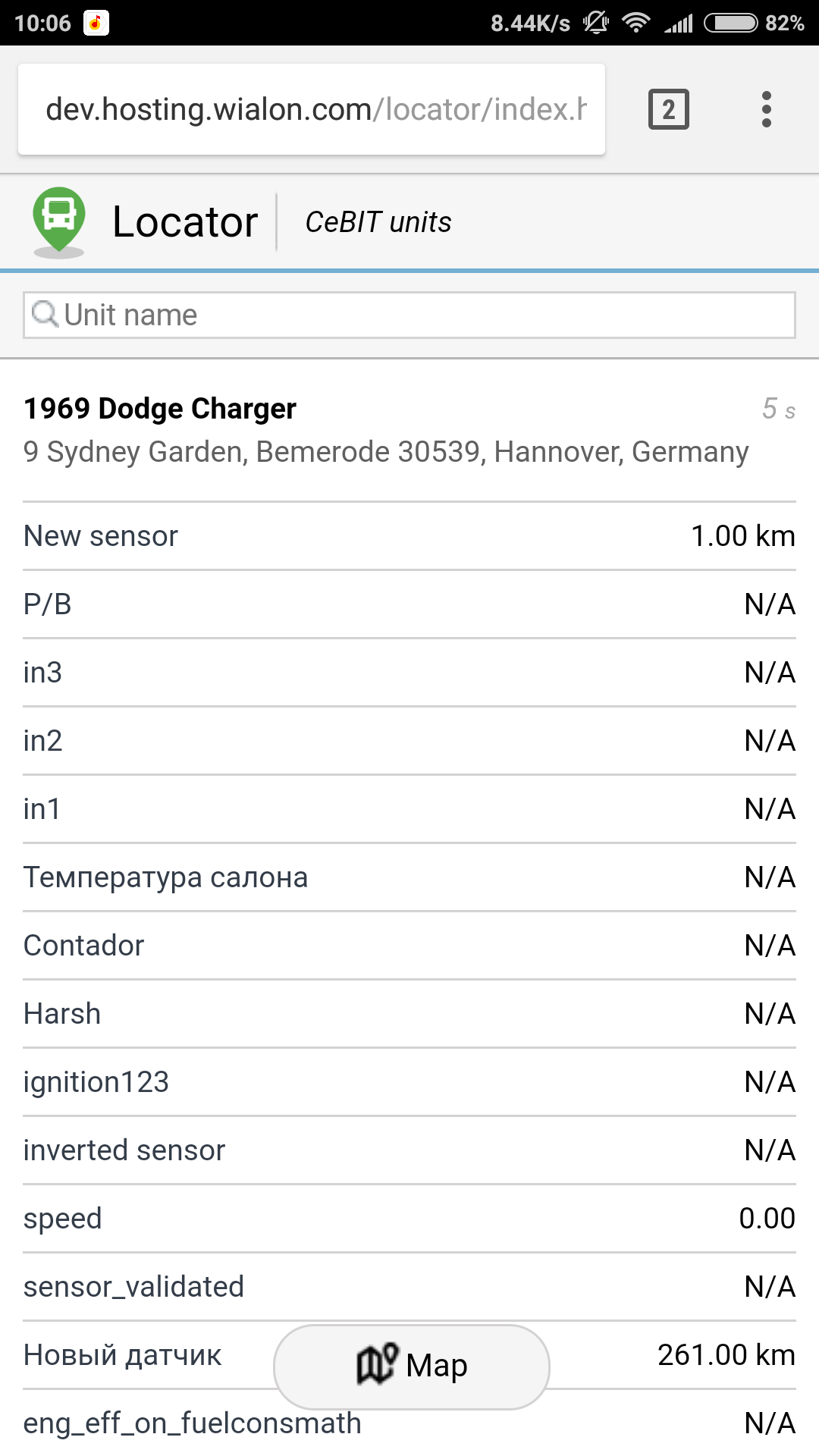

ysv wrote:
Would be nice if we can see the sensor values on Mobile Browsers as well
In mobile browsers there must be button Sensors/Map for view mode switching. If not, tell about your mobile os, browser and version.
Hello ,
I dont see the Sensors button ,
Using Android (Chrome browser)
Okay ,I created new Locator link from "dev.hosting.wialon.host" and it shows the sensors
Very nice .
Thank you.

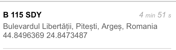

Hello,
I have a couple of enhancement ideas:
1) Add the coordinates of the unit under the address, or in a place where they are easy to be copied. Our customers need to copy the exact position of the unit. Addresses do not give the exact position. Users of the locator link, copy the coordinates in different other software programs (registering the position of the unit on different transportation websites), and they do this many times, and they need the process to be very fast. So a simple 44.8496369 24.8473487 (latitude & longitude on the same line) under the address would be great. I have attached a concept image.
2) Show the list of units on the left, even if no sensor mask is added.
Thanks.

Hi lucian.serb,
1) Ok, we will take into account your proposal on the next update of Locator.
2) You may show the list of all units on the left-hand side if you write the name of the non-existing sensor when creating the locator link.

Hi Pavel Bushuyeu
That's great news about the coordinates. Our clients will be very happy.
About the unit list, I can see that I can enter a simple space in the Sensor Mask location, and it works. But I think it would be a better user experience if that would not be necessary. If you think about it, the list of units together with their address (and coordinates) is not necessarily connected with the device sensors.
This is not a big problem at the moment. It is more of an inconvenience. It would just be nice if in a future update this improvement can be implemented.
