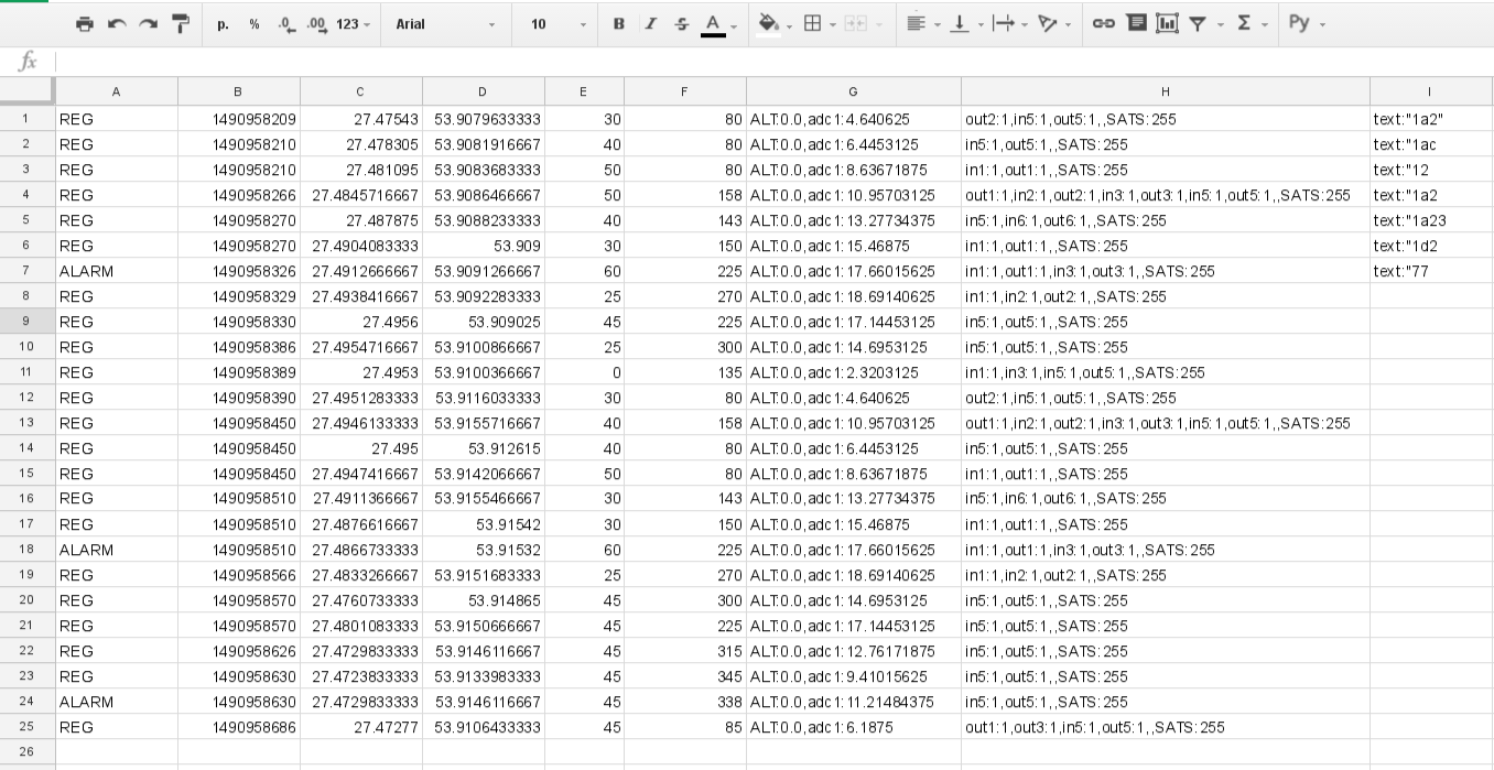

Did you try to open .wln files with Excel?
.csv and .wln files have the similar structure. Choose semicolon as a separator and get the result like on the attached screenshot.

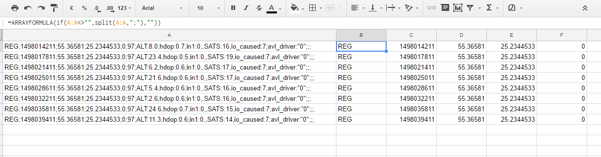

Currently messages can only be exported as .wln, wlb, .txt, .log
However if you export as .wln the data appears in the following format
REG;1498025011;55.36581;25.2344533;0;97;ALT:21.6,hdop:0.6;in1:0,,SATS:17,io_caused:7;avl_driver:"0";;;
Once you  copy this into your spreadsheet you will be able to split them by semicolon  using the following formula
In google spreadsheet you would do the following
=ARRAYFORMULA(if(A:A<>"",split(A:A,";"),""))
