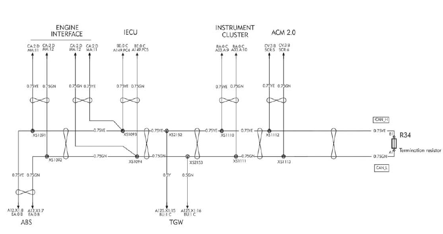

We are using the Can Crocodile to connect to the CAN Bus of the NIssan UD.Funny thing is we have got the official diagrams of Nissan, but yet we are not able to get more than 4 pieces of data.
When we connect to the OBD11 Port we get 4 pieces of data, however when we connect to the other areas of the can network on the vehicle we get nothing. When connected to the OBD Port the can crocodile acts more appropriatly witht he green light blinking on and off showing that it is recieving data.
When connecting to other areas of the network it seems to be Always On maybe it means too many message or maybe there is somthing else wrong.
We tested the Can Bus wires and we found the Voltage of Can High was 2.6 Volts and Can Low was 2.3 Volts. According to the diagram it seems that the wires are correct. Unless we are missing somthing . Please find picture attatched.
We have tried already to connect to the can twisted wires on the Instrument cluster, the ABS, to the ECU A149PC.  In all areas we dont get any data, and the can croc stays contantly on.

Hello,
Did you try to make connection without CAN crocodile? If speed of CAN bus is 500kbps you could have problem with CAN crocodile. It doesn`t work well with high speed CAN bus.
