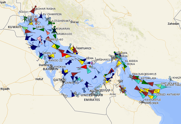

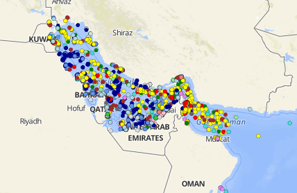

As we have Mini Map function in Wialon, it would be interesting if we have an option to show units with points om map not their icons in some map zoom. for customers with huge numbers of units there will be many overlapping icons in map. if we have them in main map with mini points and just observe exact units on mini maps we can solve this issue. it would be more convenient if points colors show sensor status as well. Regarding this issue i attached 2 screenshots from another tracking platform (maritime one). What you think?

For this problem, 3 solutions come to my mind at once. Maybe, you're already aware of them, maybe not. Let's see:
1. For overlapping units, have you considered to use the option "Display overlapping units in one icon" in User Settings?
2. And have you tried the option to "Replace unit icons with motion state signs". In this case, those "signs" will be colored according to sensor's values.
3. Check our Icon Library app. You can upload desired icons there, and they may be much smaller than our standard icons.
