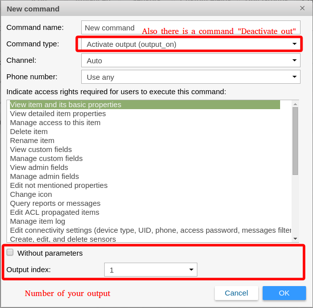

The maim idea is the same for both of your solutions: by command from Wialon you should commutate the state of some Teltonika output.
We created special commands: activate and deactivate output.
Please see attach.
About hardware installation.
The basing idea -- you should find the description of electronic block of central locking system in your vehicle and connect the output of Teltonika to this block (using relay or without it).
Nobody can help you without detailed information about electronic circuit of your vehicle.
