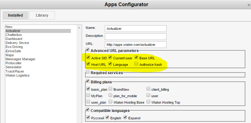

Hi Spev
Thanks for the reply. Can you share in which area of the app configurator i should add my custom parameters. I have attached the app configurator screen shot.
Thanks

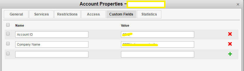

Hi
In Javascript API how to get the Custom fields of an Account using logged in users object.
I have attached the screenshot of the account custom fields
Thanks

Re: How to upload an app into account Gurtam?
prabhu.janakiraman, to get user's account custom fields use such request:
var accountId = wialon.core.Session.getInstance().getCurrUser().getAccountId();
wialon.core.Session.getInstance().searchItems({itemsType:"avl_resource",propName:"sys_id",propValueMask:accountId,sortType:""}, 1, 137, 0, 0, function(code, data) {
console.log(data);
137 - flags:
0x00000001 - base flag
0x00000008 - custom fields
0x00000080 - administrative fields

prabhu.janakiraman, as for additional custom parameters - You can pass them to app.
Just set app URL in CMS Manager with Your parameters, for example:
http://my-dns.com/myapp.html?test=123&param2=ok
It is working fine Thanks so much. But only after doing the below 2 steps only i get the custom fields as per your code logic. we should first load the custom fields library then we should update the session flags to fetch the customfields properties then if we call your code it is working fine.
var session = wialon.core.Session.getInstance();
session.loadLibrary("itemCustomFields");
var flags = wialon.item.Item.dataFlag.base | wialon.item.Item.dataFlag.billingProps | wialon.item.Item.dataFlag.customFields;
setupPayment.session.updateDataFlags( // load items to current session
                [{ type: "type", data: "avl_resource", flags: flags, mode: 0 }], // Items specification
                function (code) {
             //here we can have your code to get the custom fields data
Thanks
J Prabhu
