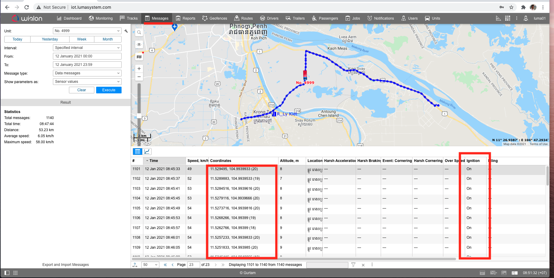

Hi, I want to get history of unit locations with sensor values (eg. Ignition On/Off)
Just like in the image.
What API should I use?
  • Get sensors values for all vehicles

Re: Get sensors values for all vehicles
kruyvanna пишет:
Hello!
The response above https://forum.gurtam.com/viewtopic.php? … 83#p177683
