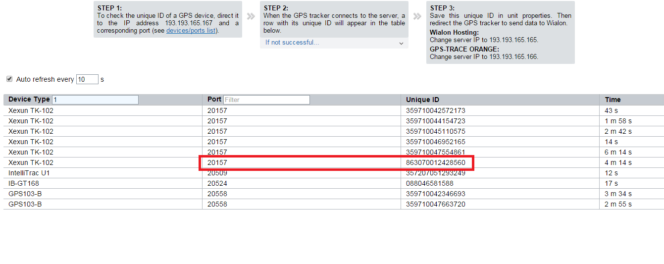

hello consultation i'm trying to enter the GPRS system on the server but can not.
Follow all procedures,
APN
adminip123456 193.193.165.166 20558
up
fix003n003s
IMEI 868683*****5685
I have a tk103B but I do not see in the software.
and according to my IMEI to port I advise?
port 20157?
Please help.

Hello
Follow this sorry late reply
commands
begin123456
APN123456 YOUR CARRIER APN NAME
UP123456 USERNAME AND PASSWORD OF YOUR CARRIER
ADMINIP123456 193.193.165.165 20558
GPRS123456
FIX030S***M123456
TRACKER123456
device should be working well
send check123456 to check for device if has gprs and gps active
