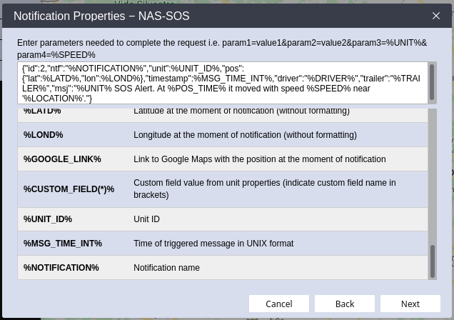

Hello guys, Is there an option to add the resource id to a notification similar to unit id value?
Right now, We are working in an app to manage wialon notification and get stat based on those so I need to send these to flespi (Just for redundancy of almost 24 hours) next from flespi to my database, but I have no idea to which resource belongs this notification when it comes from flespi, besides our app will work in to many user, resources and accounts. For those reasons I need to know if it is possible four you to add an additional element to identify the resource.
Regards

Thank you Dear Mapa, but I mean add the reource id in "the body" of the notification like wialon currently has the unit id. Please see the attached file.

Thank you for your clarifications, cerpas. However, we have no plans in adding such placeholder to the text of the notifications at the moment.
It will be much faster and easier for you to use the API for notifications that contain resource id (the link from the previous message).

Thank you for yout feedback use the API is really hardcoding (specially for routes and geofences), but I guees that I will append a notification generator in my app or something like that.
