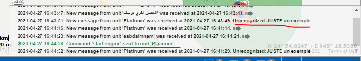

Hi thanks for the reply if I set this with APi i am getting "
Unrecognized:JUSTE un example"
and same from penal got this message
Command 'start engine' sent to unit 'Platinum'.
params={"itemId":11489,"commandName":"start engine","linkType":"","param":"TawasolMap","timeout":1,"flags":0}&sid=09fff31a9820105727644773ba146a80

Hi!
The device send this response to your command as I see on your screenshot, because there is not correct parameter 'Juste un exemple' for command. You need to send command (create command before for unit) with correct parameter for certain command. Please look to device's manual or request to manufacturer  which parameters are correct for this command type.

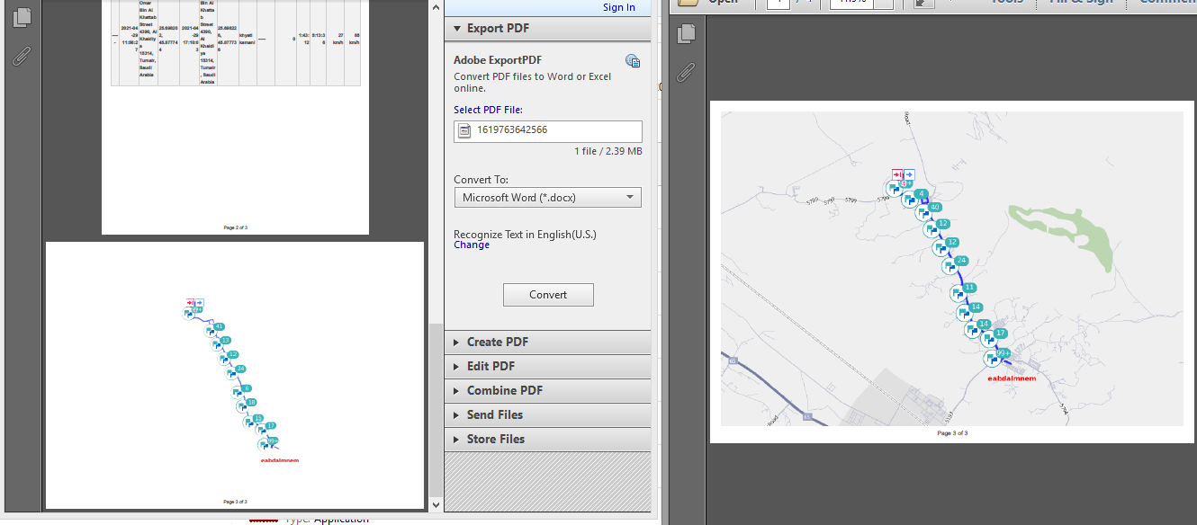

I just want to know how I can display Map on the report please check below API request
{svc=report/export_result, params={"format":2,"pageOrientation":"portrait","pageSize":"a4","pageWidth":0,"coding":"utf8","delimiter":"semicolon","headings":0,"compress":0,"attachMap":1,"extendBounds":0,"hideMapBasis":0,"outputFileName":"eabdalmnem_30-04-2021"}, sid=d628a7f4e54b4cb31c928154b234cbb8}
I had reviewed with hideMapBasis hide map layer: 0 - no, 1 - yes
"extendBounds":0
"hideMapBasis":1
"extendBounds":1
"hideMapBasis":1
"extendBounds":1
"hideMapBasis":0
extendBounds=0
hideMapBasis=0
Please find both files different only is right of the screenshot with map and left is without map.

1. If you need to attach map to the exported PDF file, you need to pass parameter "attachMap":1, "hideMapBasis":0
"hideMapBasis":1 means tracks and markers are shown on the blank background
"extendBounds":1 means option Squeeze in all graphics
For example, parameters for request  report/export_result
{"compress":0,"attachMap":1,"hideGoogleLinks":0,"extendBounds":0,"hideMapBasis":0,"pageOrientation":"landscap","pageSize":"a4","pageWidth":"0","coding":"utf8","delimiter":"semicolon","headings":1,"outputFileName":"Volvo_awesome_!gtest_Eco_driving_03-05-2021_14-38-20","format":2}
