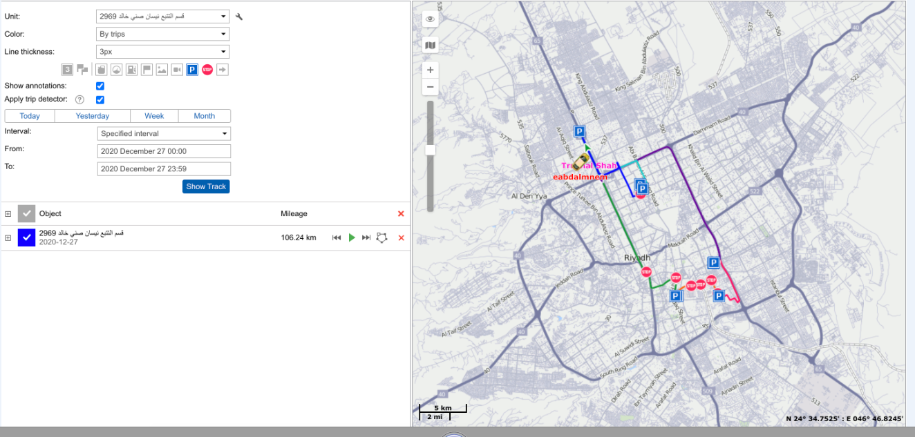

Here how we can get stop details of the unit movement for track pages
please check the screenshot, we need to display the same stop icon on the map

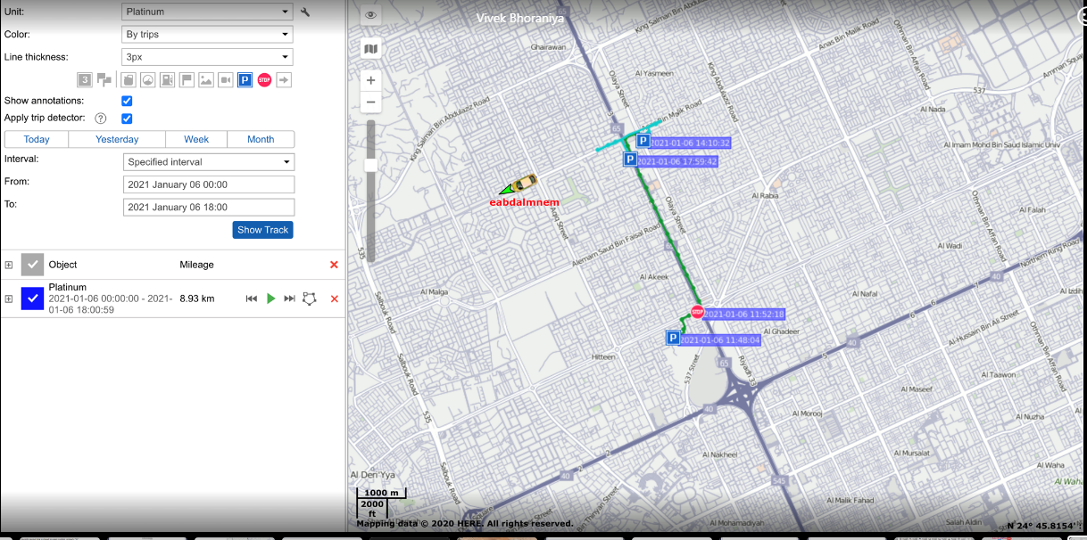

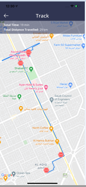

Hi, thanks for the reply this works
but still, there is wrong location data on the map of the parking and stop comparing with webpenal
All data under s>1 consider as stop with less than 5 min different
As we compare with backend penal and mobile few locations consider as parking is considered as stop in the mobile.
1)i have attached a file of the response
2) screenshot of the web model with stop and parking
3) Mobile same request data with stop and parking
which condition would make can get same stop and parking location as web track on the map

Hello, trushal.shah
There are used different algorithms (Real-time Data Processing vs Processing Messages from the Database upon Request)  to proceed data via events (for example, Wialon mobile app) and Tracks on web site,
More about it here https://docs.wialon.host/en/hosting/user/data/data.  The results depends on the unit data - how it sends, what parameters and etc.
Unfortunately, it's hard to understand what's wrong on screenshot. Please provide a full request which you execute to get trips / stops data and a real location with time intervals of stops for unit.

Hello
thanks for the reply,
Sure i will do share more details with API call, response and mobile view with webview
In the share screenshots different is that
all location which we get as stop in the API are considered as Parking in the web,
so just want to know how we can get parking data stop data from the API
do we need to add any type like ignition?

When data are get via events(or in reports proceeded), there is not parking or stops events type, only trips (motion) detected by unit Trip Detector
The parkings/stops system is calculated additionally (you cannot get them via some API) :
The parkings are intervals between trips
For example   1st trip - 10:20 - 11:20
2nd trip  11:50 - 12:30
So the parking is 11:20 - 11:50
The stops are intervals inside trips where the speed is less then value Min moving speed.
For example, 1st trips - 10:20 - 11:20  where speed is less than 1 km/h (default value Min moving speed)  in messages from 10:21 till 10:24, so 3 minutes is stop.

Hello
I do send this message to get track data of the unit same as wialon page
same as the first image and the second image
but we are struggling to get data. we applied the same login you suggest getting between time data
its not sufficient to get the same data as the web does we if we apply s<1 then we are getting all the stops which are not there in the website
below is API call we done
APi URL:
Dates select 11/01/2021 to 12/01/2021 and unit id as 11489
http://gps.tawasolmap.com/wialon/ajax.html?svc=core/batch&sid=bdfabd36adfb22323b0a292ceb799ed5&params={"params":[{"svc":"events/load","params":{"ivalType":1,"itemId":11489,"timeFrom":1609439400,"timeTo":1609525799,"detectors":[{"type":"trips","filter1":0},{"type":"ignition","filter1":0}]}},{"svc":"events/get","params":{"selector":{"type":"trips","timeFrom":1609439400,"timeTo":1609525799,"detalization":11}}},{"svc":"events/get","params":{"selector":{"expr":"trips{s<1}","timeFrom":1609439400,"timeTo":1609525799,"detalization":11}}}],"flags":0}
let me know token required
and also I have attached result we from API call
check attached images that we need same stop and parking would display as wialon web/track page has
Please help me with this would much appreciate

Hello!
The same different time interval in request  and on screenshot.
"timeFrom":1609439400,"timeTo":1609525799 :
Thu, 31 Dec 2020 18:30:00 +0000
Fri, 01 Jan 2021 18:29:59 +0000
On screenshot Jan 6, 00:00-18:00 (regarding users timezone).
You write about other dates Dates select 11/01/2021 to 12/01/2021
Sure you can get different result on different intervals.
You can open Developer Console and look which time(from/to) is passed in request to get track data.

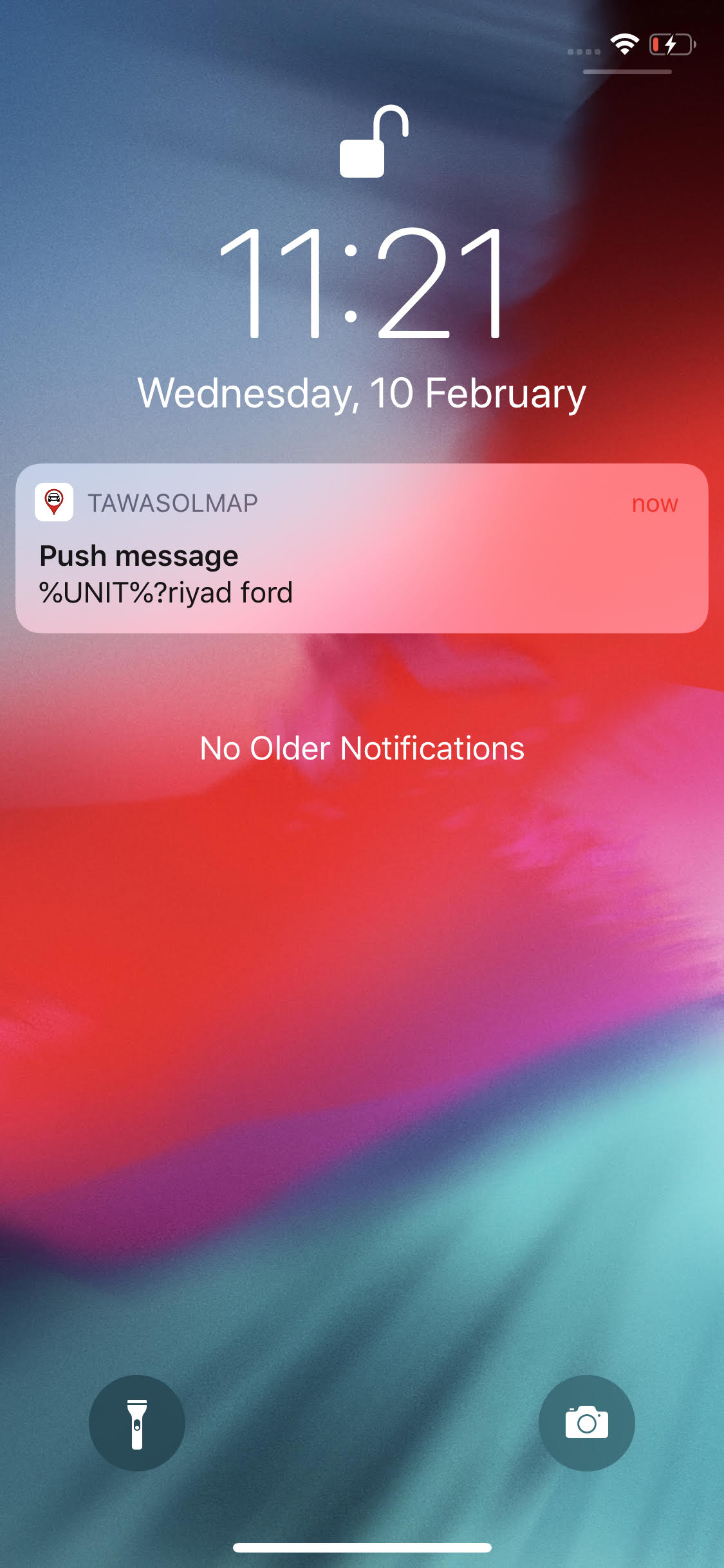

Hi, thanks for the replay this working fine, and we are getting notifications
But if I set the URL as this then getting as attached screenshot notification
https://localhost/front/api/v1/send_push?user=brainvire&msg=%UNIT%
and our requirement is to send message same
%UNIT% violated speed limitations. At %POS_TIME% it moved with speed %SPEED% near '%LOCATION%'.
How I can set this if you can please guide me

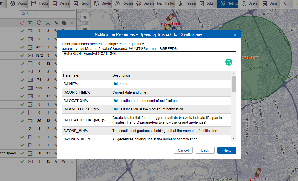

the issue is with Notification text with space is not working
"txt":"Helllo UNITName%UNIT%Current_Location: %LOCATION%Current_Time%CURR_TIME%"
Notification got just Hello text rest of the message skip due to space, if we have remove all space then its working
like this "txt":"HellloUNITName%UNIT%Current_Location:%LOCATION%Current_Time%CURR_TIME%"
check the attached screenshot

Hello!
Try to type  URL-encoding %20  instead space

thanks for the reply but still looks its skip the notification text with space, even from penal also
txt: UNITName: %UNIT% Current_Location: %LOCATION% Current_Time %CURR_TIME%
encode text: UNITName%20%25UNIT%25%20Current_Location%20%25LOCATION%25%20Current_Time%20%25CURR_TIME%25
But still its skip with space

Hello!
As I said before, it's better to send text as JSON parameter string type, i.e notification text is like paramName={"spec":"%UNIT% unit and so on %some_other_wialon_tags% some text with spaces"}
Sure the server should parse parameter paramName as JSON
In any case you should look through server parsing which get message from Wialon.
