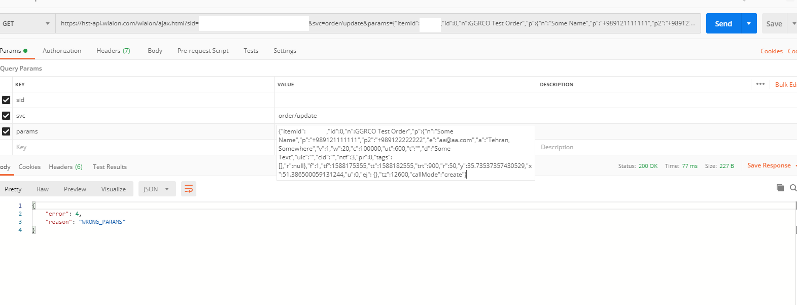

i have attached the postman message i just removed the sid and account id
  • Create Order API
Create Order API
Re: Create Order API
Your params are ok, everything works.

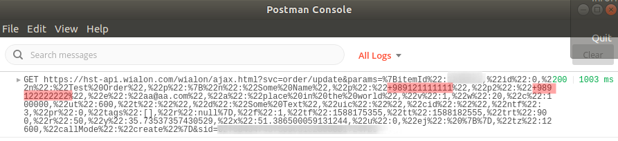

The issue is with '+' sign in phone number, it must be encoded but Postman skip it in GET method (see screenshot)
Wialon Remote API should be used with POST method (see docs), it solves the issue.

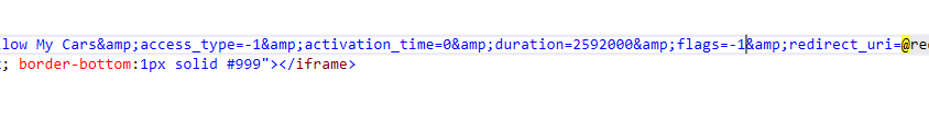

am using the iframe login and set the access type and flags to -1 which should be unlimited access
  • Create Order API
Create Order API
mfathy, simply check if the account your are using for API has access to Logistics on web version and if it works fine or not. If No, then the problem is related to access of account.
